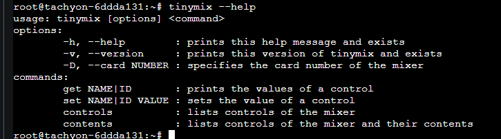

root@tachyon-6ddda131:~# tinymix -a
tinymix: invalid option -- 'a'
no command specified (see --help)
These are the options I see:
Controls lists more data than the terminal online can handle co I can’t copy paste it all.
