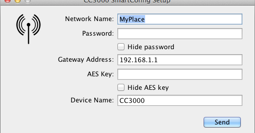

I have no android or ios device and I got the core to connect using:
