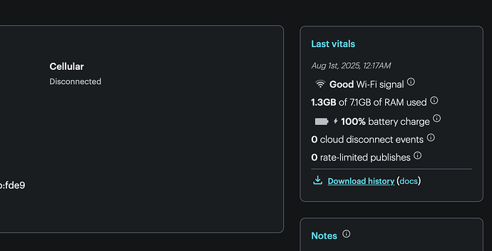

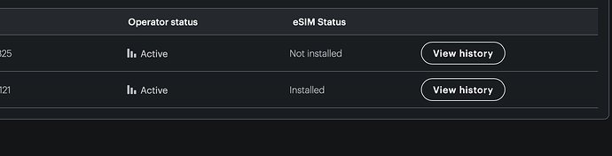

A couple of more details. It looks like this time we have one SIM showing as installed, in prior attempts both showed not installed (I think):
But I still see Cellular: Disconnected:
