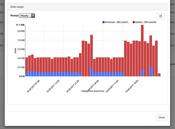

I took a view at my third party’s SIM data volume usage dashboard and what I see is really weird:
Normally data usage is always centered around 3.9Kilobytes / hour - but those peaks do absolutely make no sense since I am not changing the code …
And since within those peaks there is no download (blue) I am pretty sure that there is something wrong with connection to cloud since it seems like the device performs retries since it does not get the desired data!
BTW I am not “pretty sure” - I simply “strongly believe” that this is a connection error - the device does transmit - even in those periods in which it seems that not publish is being send - but it somehow looses connection and performs retries …

But really - have you seen my screenshot of the data volume dashboard - that’s something I haven’t seen before - those peaks are weird - but even more weird is the fact that there are periods with no download to device …

Well I have just that third party SIM but I can say that with using no sleep the data is constant - and I can say that the weird data usage corresponds to those dropouts …
