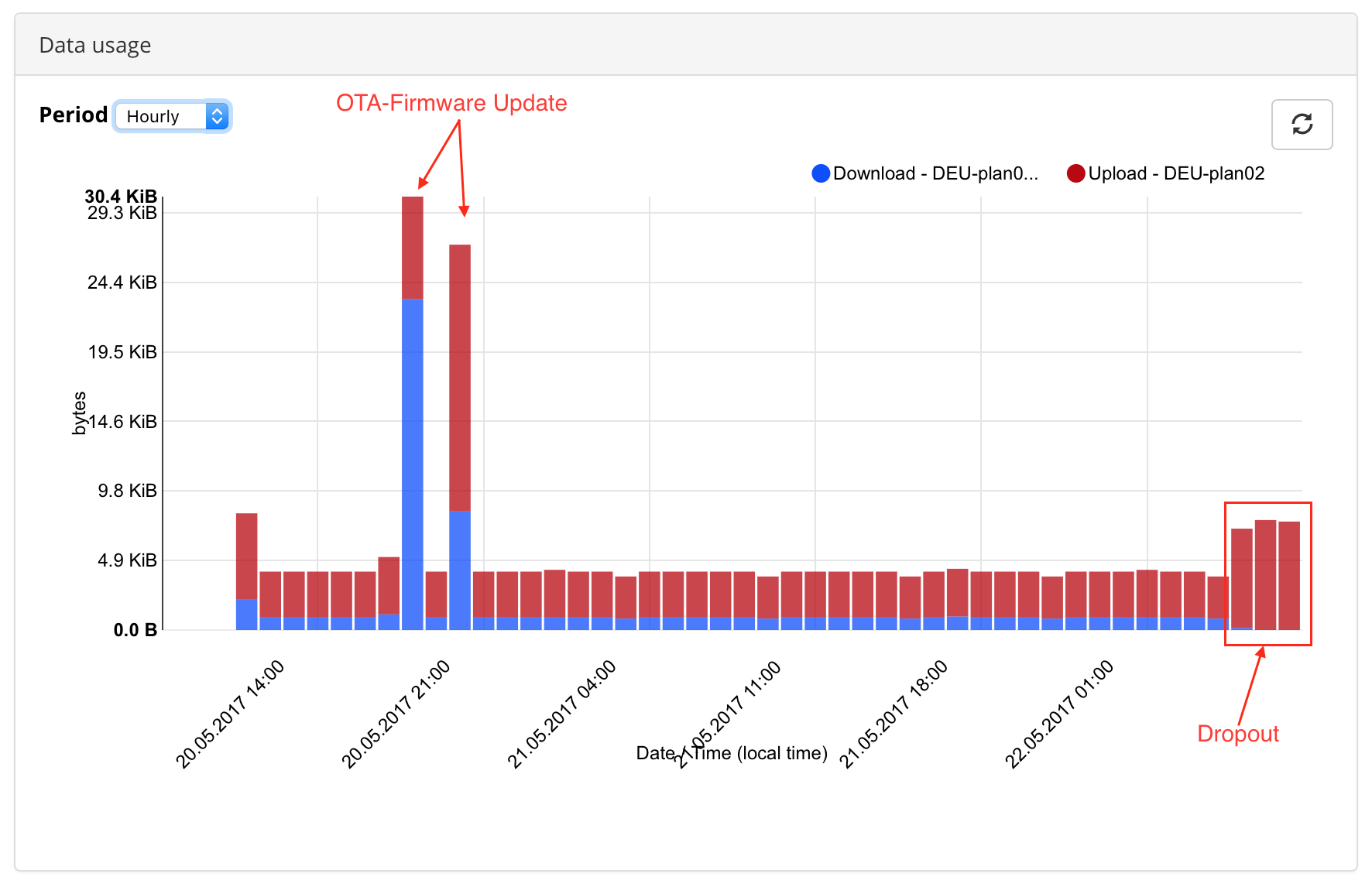

  3. My third party cellular ISP says that there is connection being made - and - you can easily see the dropout and how it affects the data usage (See screenshot attached below)
  4. Before issue appears the Electron(s) can publish for days - but after it appeared - even after resetting the modem - it just takes a few hours for the issue to reappear - once even just a few minutes (!!)
Here's screenshot from my third party cellular ISP:
