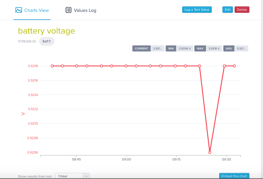

I watched the Electron and console log for the last hour while running your code above exactly as written. I’m still going to run code longer and am waiting for console to update with data usage, but wanted to post observations so far. The publishes are not reliable.
  1. There’s a clear pattern in the interval between publish events and failures. There’s a sequence of 3 events that repeats:
    i) t = 0, fuel-level1, breathe cyan for 60 sec, sleep;
    ii) t = 3 min, fuel-level1, breath cyan for 3 sec, sleep;
    iii) t = 5.2 min, Came Online (no fuel-level1), cyan blinks 3 sec, rapid flash 5 sec, sleep;
    iv) repeat cycle 2 min later.
  • Is the 60 sec breathing cyan waiting for an ACK?
  • Why does device ‘come online’ every 3rd cycle instead of publishing properly?
So, I’m only getting 2 out of 3 packets. This is reflected in M2X data as well.

Results of new code without SYSTEM_THREAD. Different pattern, but still strange and not reliable timing.
ii) t = 3 min, fuel-level1, breath cyan for 5 sec, sleep;
iii) t = 5.2 min, NOTHING in cloud, cyan on < 1 sec, sleep;
iv) t = 7.2 min, Online AND fuel-level1 packets, cyan blinks 3 sec, rapid flash 5 sec, sleep;

I ran RWB’s code (part with and part without threads) for about 3 hours over which there were about 70 fuel-level or ‘online’ connections. The console started at 0.28 MB (had not run all night before this test) and is now at 0.40 MB (about 2 hours after Electron turned off). So, 0.12 MB is about 1.7 kB per connection. :dizzy_face:
