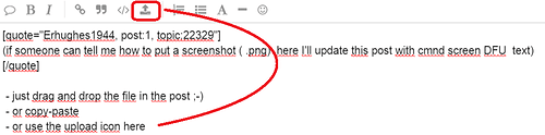

Summary: using a problem free example blink-an-led1.ino for test, I have the following problem. WEB IDE it works great if I use OTA. But flashing the same binary file --serial , the cyan led blinks rapidly as it should then goes to safe mode w/o ever breathing (that I can see) The same thing happens if I use the DFU batch file in DEV. I powered everything on and off including my WIN10 system. The extensive handshaking in the DFU process would seem to rule out driver, power, cable problems. The electron has it LiPo battery connected and I checked voltages to rule out low power flakiness. Up till this sudden roadblock I was flashing --serial 10x a day w/o a hitch. I just start using the DFU batch file but did it at least 10x w/o problems. The device manager shows electron COM3 so everything looks good there. Yes, I have the electron blinking yellow for the batch file DFU For the moment, take my word that the DFU batch file says success several time ending with “file downloaded successfully” (if someone can tell me how to put a screenshot ( .png) here I’ll update this post with cmnd screen DFU text)
