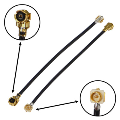

I got one of these:
so that I can try various ufl ended antennas without fear.

I soldered mine after my boss broke it off, kinda hard to see the solder pads but fairly easy to do
I soldered some of my antennae too. If you’re going to connect/disconnect it a lot, you may want to consider purchasing an u.FL to SMA or FME adapter, with an accompanying antenna. u.FL connectors really aren’t meant to be disconnected
I have some TG 22.0222 (FME connector) antennae, works great and they’re firm and compact.
