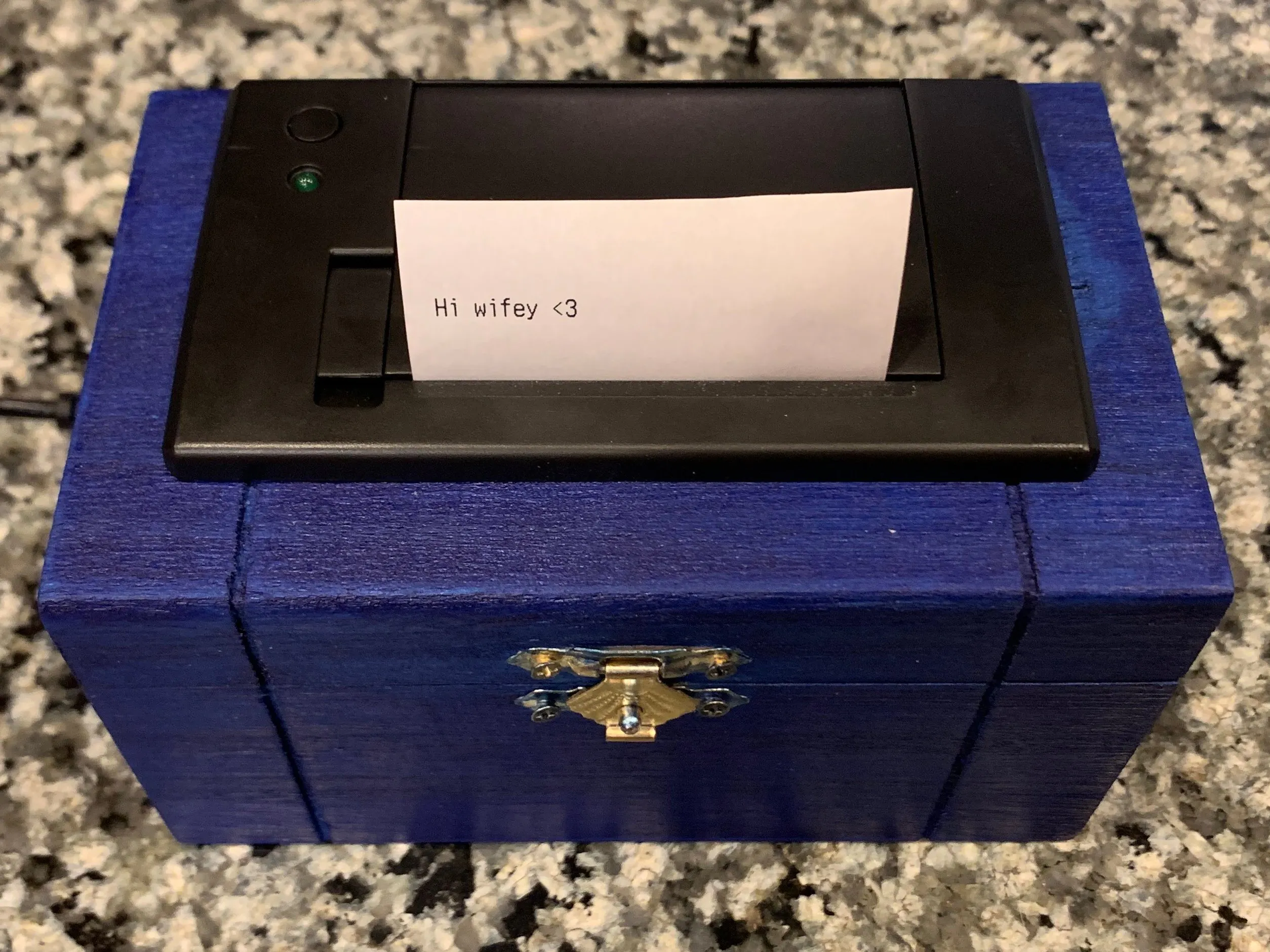

I'm building an Wifi lamp with an integrated Thermal Printer to connect me and my girlfriend between countrys.
