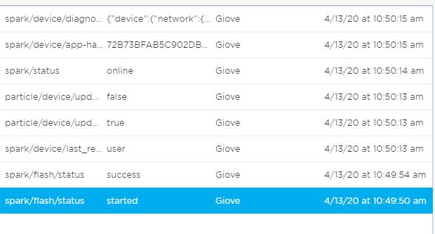

just to clarify, I have some Particle Boron and Photon modules that are running, the variables respond to the get with the right values. Unfortunately in two that I use to perform tests in the early morning before 08:00 they work well and they respond to get, after this time if I run flashes of my code the variables are no longer visible in the console. Same thing if I run either from Iphone or from PC the Tinker app I don’t see the variables in the console but neither does the app work on the mobile phone.
As already expressed yesterday I want to understand if this comes from an overload from my provider or an overload from the Particle cloud.
Best Valentino
This is the Last Vital when i flash tinker from Iphone
