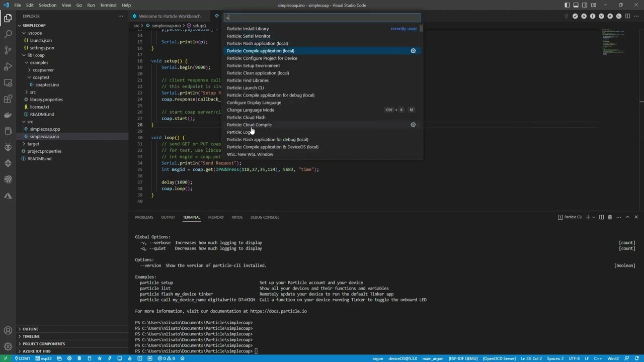

Now I update the coap library to 0.2.5 version.
Here is "How to build & test the CoAP community library on Argon(firmware 5.3.0)"
Thank you.
