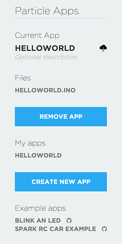

@gotopcs, you CAN use the web IDE to download the bin file which you can flash via USB. Simply click on the “cloud” icon on the RHS of the app name to download the bin.
Thanks for that. I have downloaded my compiled code, so next step will be to try to flash it to the Photon (when I get home from work).
