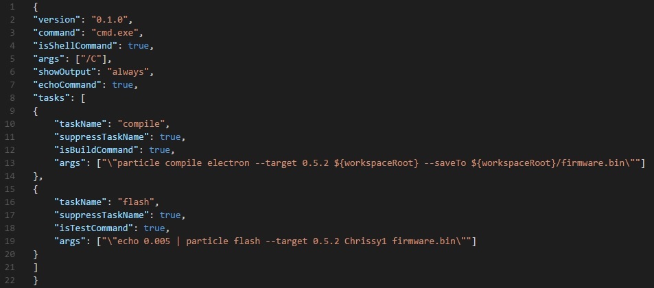

I’ve tried piping an echo of the value I have to enter after flashing (0.005) and I tried to run it as a second command using && after a delay. Here is my tasks.json file:
