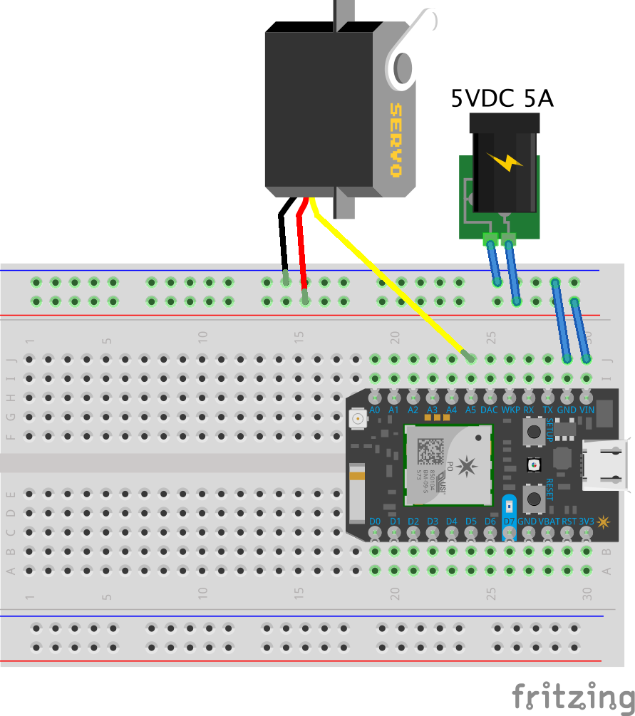

So the following image should be an acceptable way to power the Photon and Servo?
Yes, that is correct.

Thank you both for your input, I am including an updated picture to make sure I understand the addition of the capacitors.
Per another post, I saw something similar on the 3V3 pin. I opted for a schematic as it was getting cumbersome to try and represent this in the bread board view, but essentially, I understand the capacitors to straddle the power supply lines to the photon.
@ScruffR, can you comment or provide a link as to what adding these two capacitors accomplishes? I saw another post mentioning something about filtering, but didn’t get into details.
Again, thank you for you help with learning something new.
Yes, exactly that.
