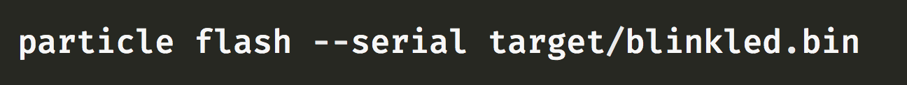

which did not work for you. I did a make with the following:
Then I flashed it through WiFi update where photon LED was "breathing" cyan:
This worked for me. You might also try other methods:

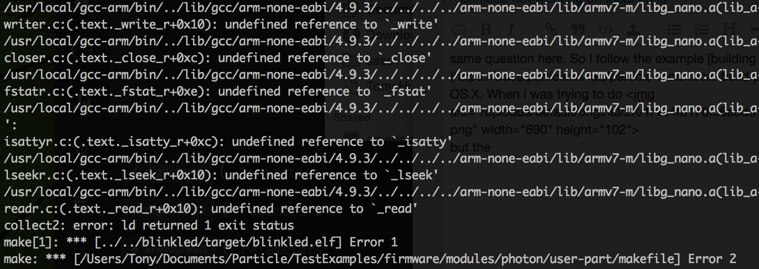

same question here. So I follow the example building locally by gcc-arm toolchain in OS X. When I was trying to do
but the the outcome is
as @fajak93, I just use the first example in blinkled.cpp. I thought the reason it does not work because blinkled.cpp cannot be compiled, then add #include <application.h> at the beginning of it. However, it still doesn’t work, even I tried just arm-none-eabi-gcc-4.9.3 blinked.cpp , it shown
⇒  arm-none-eabi-gcc-4.9.3 blinked.cpp
blinked.cpp:13:25: fatal error: application.h: No such file or directory
 #include "application.h"
So I am not sure which part I did wrong, do I need to make the blinked folder structure as a project structure which including necessary libs?
Any advices?
