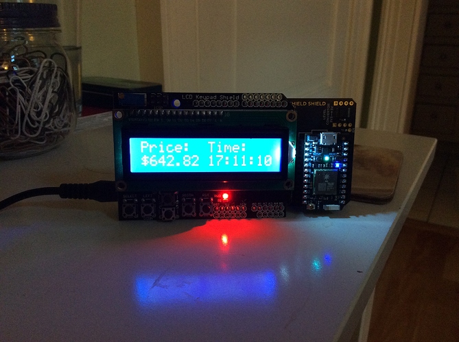

###Today I made a Bitcoin Price Clock using a Particle Photon, my new Particle Shield Shield, and a LCD Keypad Shield that I had lying around.
Here is a picture of the clock:

I hope you enjoyed my project of the day and I hope to make more random projects like this.
Building this, I need a screen though, Kind of want to OLED it…BTW isn’t the shieldshield a sexy piece of kit…black solder mask, mmmmm.
Thanks for sharing this! I look forward to what you build next @nrobinson2000!
