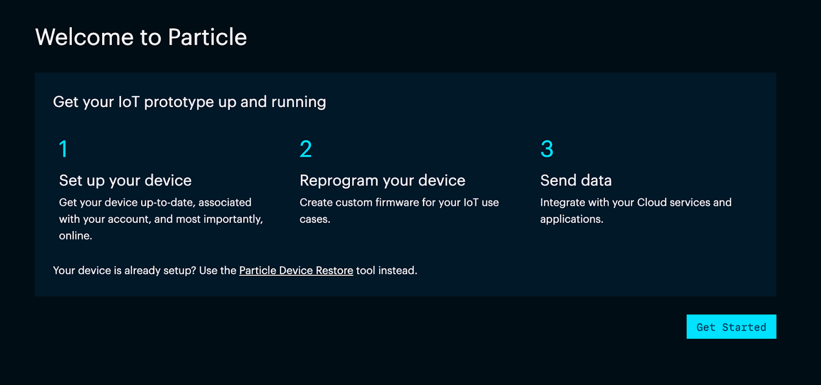

Announcing the New Particle Web USB Setup
Hey Folks-
I am thrilled to announce the official release of the brand new Particle device setup process hosted at setup.particle.io! This new tool offers a seamless and intuitive way for users to set up new Particle devices, so you can get to building your Particle-powered projects as soon as possible! It also lets you set up your first product or add your device to an existing product.
Over the years, Particle has offered a number of different methods for setting up devices, ranging from mobile apps to web apps to command line tools. While the variety of options is useful, new browser technologies (specifically WebUSB) have made it possible to deliver a world-class setup experience for all Particle devices through a web browser. This new setup app is now the default experience for new Particle users, replacing the mobile setup apps which will be deprecated later this year (no earlier than Q3) in favor of more SDK-like tools for building Particle mobile apps.
Thank you to all our amazing beta testers for providing great input and feedback!
