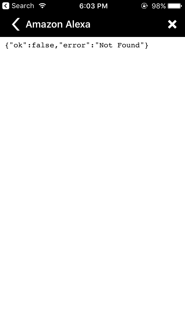

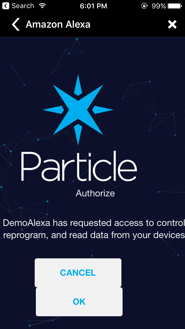

After giving permission to Particle photon i am getting this error
