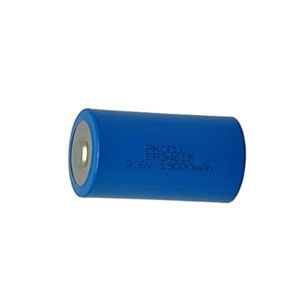

If you don’t mind using a non-rechargable battery, I’m a fan of the “Li-SOCl2” chemistry batteries: (19000 mAh, not 1900 :slight_smile: )
Something like these:
The problem with these batteries is that they are not rated to handle the peak currents of the Photon or the Electron so under 1 Amp on the Photon and 2 Amp max current on the Electron your probably going to see the voltage drop out which will cause the devices to reset.
That’s a really good point, so you might need to use 2-4 of these, or use other methods to reduce draw or add capacitance so you don’t overdraw when using those.
Just keep in mind there is some risk in parallel with certain types of batteries sensitive to over/under voltage (risk to breaking the batteries). I’d recommend charging them individually, and buying protected cells.
@qwerty, FYI, the batteries references are non-rechargeable!
