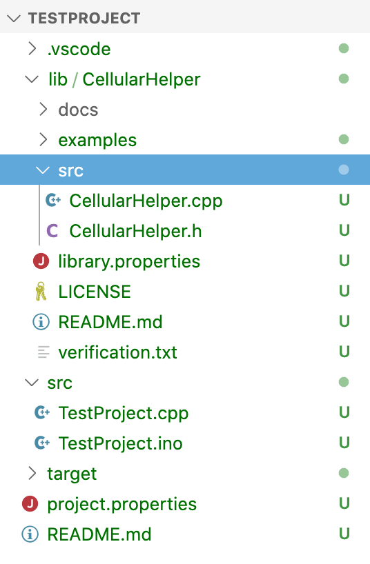

For me this seems to work (in Windows and WSL2/Ubuntu)
What I did
Particle: Create New Project
select the correct platform (boron) and target version (deviceOS@2.0.0-rc.4) via the status bar
(can also be done via Particle: Configure Project for Device)
Particle: Install Library -> CellularHelper
copy code from lib/CellularHelper/Examples/1-simple/1-simple.cpp to the projectās .ino file in src
