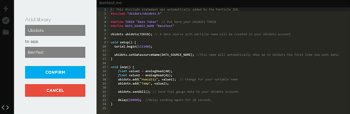

@benjiiiiuk I would recommend not using the MQTT library and instead use the legacy library.
I modified your code for you to test out.
Start over using this code and enter your Token:
#include <Ubidots.h>
#include "Ubidots/Ubidots.h"
#define TOKEN "Bens Token"  // Put here your Ubidots TOKEN
#define DATA_SOURCE_NAME "BensTest"
Ubidots ubidots(TOKEN); // A data source with particle name will be created in your Ubidots account
  Serial.begin(115200);
  ubidots.setDatasourceName(DATA_SOURCE_NAME); //This name will automatically show up in Ubidots the first time you post data.
    float value1 = analogRead(A0);
    float value2 = analogRead(A1);
    ubidots.add("Humidity", value1);  // Change for your variable name
    ubidots.add("Temp", value2);
    ubidots.sendAll(); // Send fuel gauge data to your Ubidots account.
    delay(10000);  //Delay sending again for 10 seconds.
Then you will need to add the legacy Ubidots library to this sketch by following the screen shots below:
Choose the name of the sketch you just created so we add the library to only the new code sketch:
The code should successfully compile and you should be to flash the code to a Photon or Electron.
Once you send a publish even to Ubidots it should automatically create new sources using the same names in your code called BensTest, and then individual variables called Humidity & Temp.
Hopefully that works, it’s working for me :smiley:

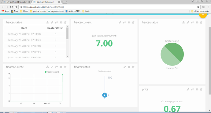

That’s great thank you very much. i know have it working with your above explanation. i kind of understand what is going on. i have also manage to incorporate this innto my website. if you use the link given by ubidots does that mean your token is not exsposed? Thanks again
@benjiiiiuk When you share your dashboard using the share code your token is not exposed so nothing to worry about there.
You can also setup email, or SMS alerts triggered by thresholds if you desire which is handy.
Share a screen shot of your dashboard if your willing. Always nice to see how others are using stuff.
Here is a screen shot of my dashboard.
I found Ubidots easy to use, thanks for the advice! it seems like a good way to get your data to the web without exposing the token.
Thanks again for everyone’s help and advice.
