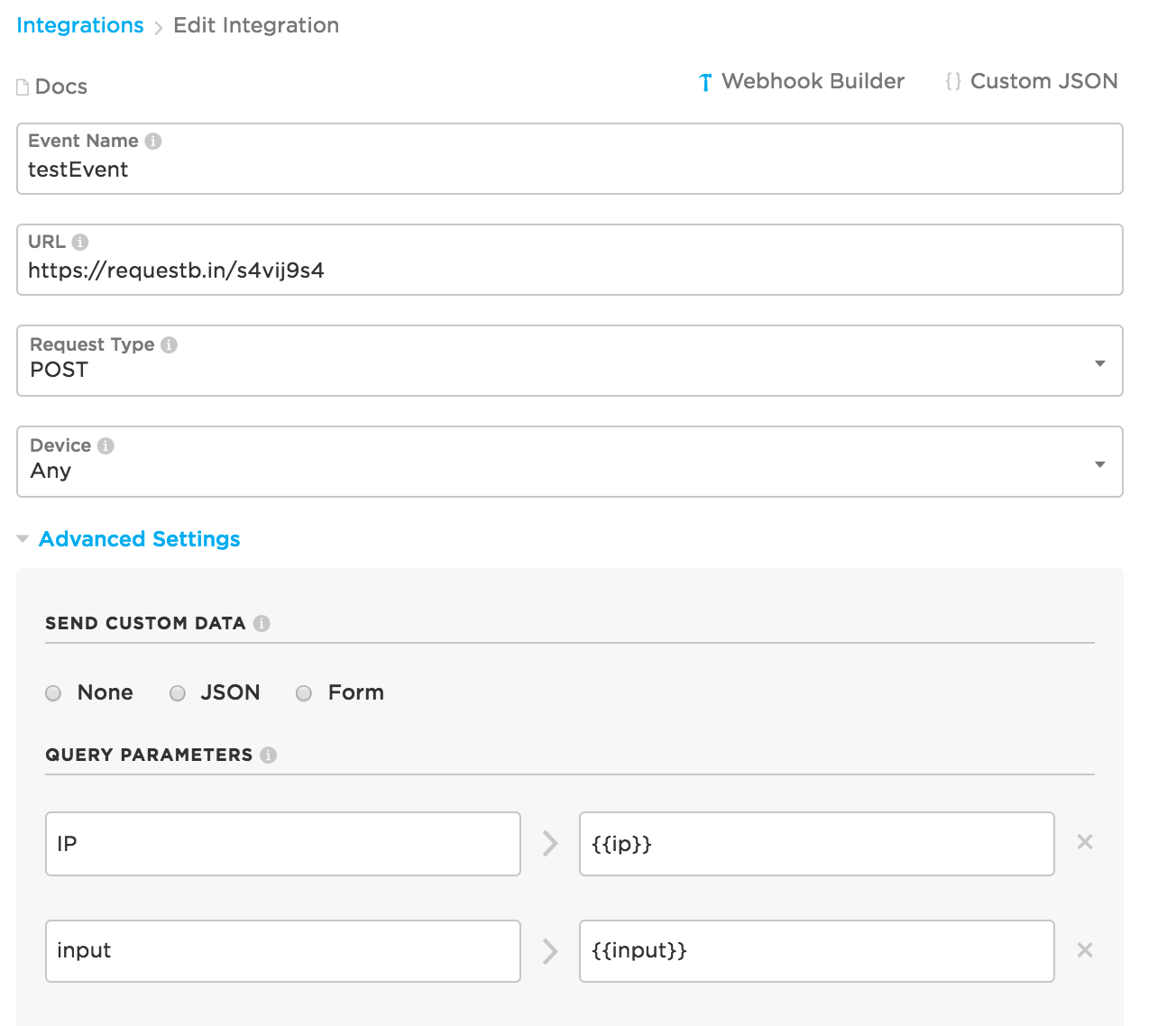

My webhook is something like:
Hi,
Apologies for the late reply.
Thank you so much. That worked perfectly!
