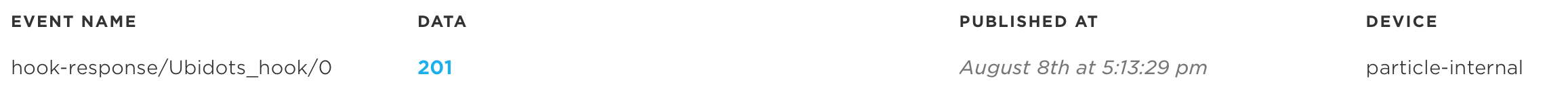

Use the steps in Rick’s tutorial for the steps to “create” and “publish” the web hook and make sure it is received by Ubidots and generates a “201” response code. See this site for the standard HTTP status codes during this step (thanks @ScruffR).

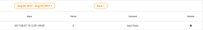

  1. Then go to Ubidots and make sure that a new data point was created for “watering” and that datapoint had a context of “Key1:Oops”.

Since I also included the response template in the web hook, I will get a simple HTTP response code (i.e. “201” when a datapoint was successfully created) back from Ubidots which will make writing the response handler a breeze. I was able to get the response template back by simply pasting the Ubidots JSON response into the Mustache tester and then worked with the response template until I got the right output.
