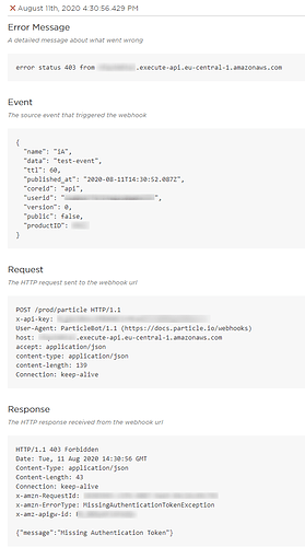

Webhook looks like following:
When testing the webhook I always get this result:
{"message":"Missing Authentication Token"}
Any hints?
