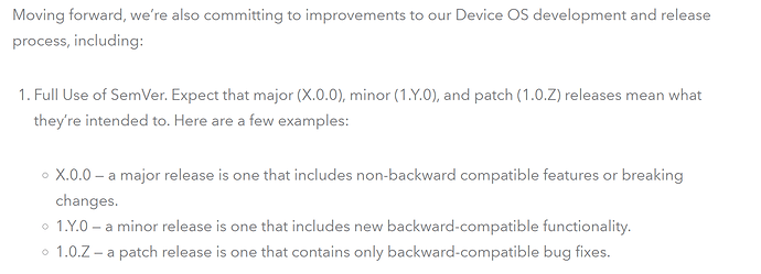

Wouldn't that mean a breaking change that would require a major version number change to 2.x.x?
Minor version change allows for adding features and (slightly) altering behaviour, but breaking otherwise working code? I wouldn't think so :flushed:
