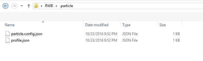

This looks like the user config stored in JSON format got corrupted somehow.
Try deleting the config in C:\Users\your_user.particle\profile.json and C:\Users\your_user.particle\particle.config.json then doing particle login again.

@jvanier@kennethlimcp OK, after looking at the laptop that has the working CLI I found the .particle folder that contains the Config.json & Profile.json files in them.
The laptop that I am having issues with was missing this folder because I probably deleted it while troubleshooting the Google Cloud tutorial Rickkas posted up a few week ago that was also giving me token errors.
I get token errors for the CLI, DEV, and the Google Cloud Datastore app.
So I copied the .Particle folder over to the laptop I’m having these Token errors on hoping it would fix the issues but I get the same Unexpected token error.
Even if I delete the Config.json & Profile.json files and then run the particle login command the same error pops up.
Even though I deleted the .particle folder in the past, uninstalling and reinstalling the Particle CLI never did create a new .particle folder for some reason. Should it create the .Particle folder every time the Window CLI installer is ran?
