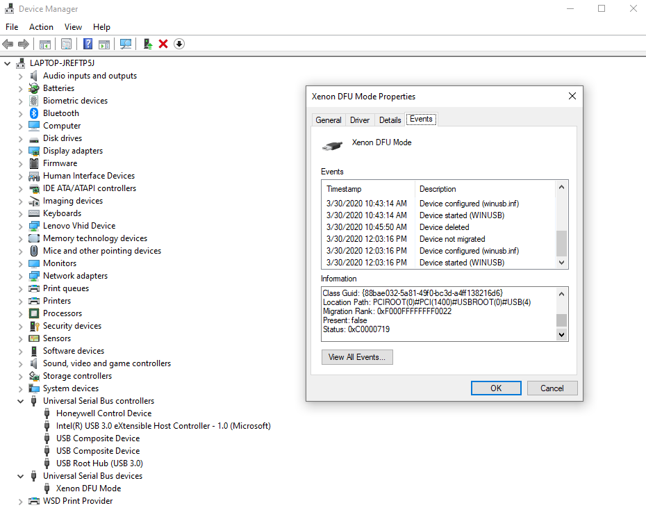

Can you post a screenshot of your DevMgr while the device is plugged in and blinking yellow?
Also, can you try dfu-util -v and also where dfu-util (in cmd - in PowerShell it’d be where.exe dfu-util)?
It should be found at C:\Users\<yourUser>\AppData\Local\particle\bin\
Installed the driver pack. In non-DFU mode, it shows as using the particle driver. In DFU mode, it is the windows drive The events are shown below

No idea why the driver pack didn’t help, but you should still be able to use zadig to install the libusbK drivers
Thanks for sticking with me @ScruffR!
I downloaded Zadig and then put the device in DFU more manually. I launched zadig and browsed for the device. The driver was a generic windows version. I then replaced it with a libusbK version. The non-dfu driver is still the particle one.
From there, I tried particle update and it got further, but didn’t complete. Then I tried particle device doctor just for fun, but that didn’t work either.

Cannot read property 'code' of undefined
PS C:\Users\snowr\source\repos\beacon-checker-logger-particle-1> particle usb list
snowrodeo-xenon-1 [e00fce681f04cf4a47e950e8] (Xenon, DFU)
PS C:\Users\snowr\source\repos\beacon-checker-logger-particle-1> particle update
!!! There was an error trying execute DFU utilities.
!!! For help with installing DFU Utilities, please see:
 https://docs.particle.io/guide/tools-and-features/cli/#advanced-install
!!! You may also find our community forums helpful:
 https://community.particle.io/
> Error code: unknown
PS C:\Users\snowr\source\repos\beacon-checker-logger-particle-1> dfu-util -v -l
dfu-util 0.8
Copyright 2005-2009 Weston Schmidt, Harald Welte and OpenMoko Inc.
Copyright 2010-2014 Tormod Volden and Stefan Schmidt
This program is Free Software and has ABSOLUTELY NO WARRANTY
Please report bugs to dfu-util@lists.gnumonks.org
Cannot open DFU device 2b04:d00e
Found DFU: [2b04:d00e] ver=0251, devnum=29, cfg=1, intf=0, alt=2, name="@External Flash   /0x80000000/1024*004Kg", serial="e00fce681f04cf4a47e950e8"
Found DFU: [2b04:d00e] ver=0251, devnum=29, cfg=1, intf=0, alt=1, name="@DCD Flash   /0x00000000/1*016Ke", serial="e00fce681f04cf4a47e950e8"
Found DFU: [2b04:d00e] ver=0251, devnum=29, cfg=1, intf=0, alt=0, name="@Internal Flash   /0x00000000/1*004Ka,47*004Kg,192*004Kg,4*004Kg,4*004Kg,8*004Ka", serial="e00fce681f04cf4a47e950e8"
PS C:\Users\snowr\source\repos\beacon-checker-logger-particle-1> particle device doctor
The Device Doctor will put your device back into a healthy state
It will:
  - Upgrade system firmware
  - Flash the default Tinker app
  - Reset the device and server keys
  - Clear the Wi-Fi settings
The Doctor didn't complete successfully. Timed out attempting to list DFU devices
> Please visit our community forums for help with this error:
I think it’s best to open a support ticket and reference this thread in it.
