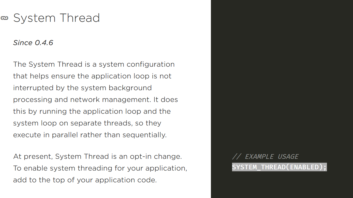

Look into system threading :slight_smile:

Yes, we get your problem. System Threading will fix this for you, it will allow the connection process to work without affecting your main loop code like it is doing now.
If you are saving data to EEPROM already then adding this line at the top of your code should fix things.
SYSTEM_THREAD(ENABLED);
