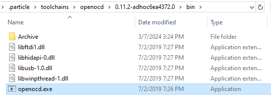

Seems when I installed Workbench on a new PC a dir went away; specifically -
*used to look like this (could run bin\openocd.exe from this 'adhoc' ) -
*but now looks like this (no 'adhoc' folder, else 'particle' still present but bin\openocd.exe doesn't work from here) -
To reiterate, both 'adhoc' and 'particle' have "bin\openocd.exe" nested under them, but the 'new setup' (thru 'particle' folder) doesn't seem to work -

To clarify: does the openocd work well on a fresh installation (new computer in your case) but it is not working when updating from a previously installed version on your old computer?
Ah, so the openocd
  • works on the 'old' PC (thru the 'adhoc' folder, installed sometime back still running Win10),
  • but NOT on the 'new' PC (w/ just the 'particle' folder, installed recently running Win11)
