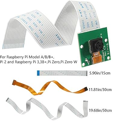

I have looked at this thing: (it dumbs down to VGA 640x480) and that would be OK if interfacing this to Particle would be straight forward:

Could do this huge overkill…
