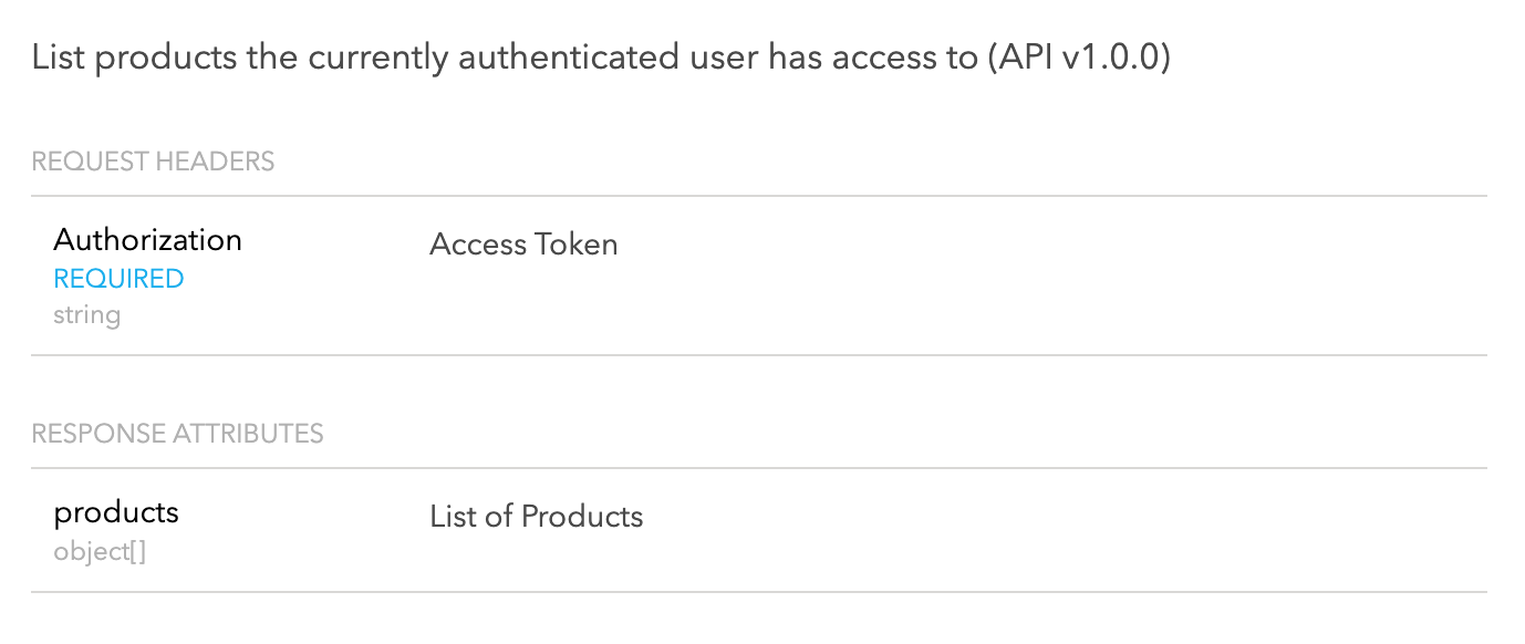

I’m currently trying to get a list of products against my account (account client is authenticated with full rights), and despite my following the API documentation, I still seem to be getting empty products array. From the call below, is there something I’m missing ?
From my gathering, all I need to do is hit the following endpoint:
[GET] https://api.particle.io/v1/products with the access token as a header, no ?
This seems to always return an empty array.

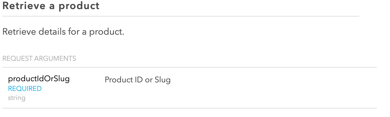

I then decided to try and get an individual product by it’s slug, or id:
[GET] https://api.particle.io/v1/products/:slugOrId which also returns an empty products array.

I can indeed retrieve single products by passing in the slug id… Small error on my end - still have issues retrieving the full list of products though.
I think the documentation on the Products API is slightly out of date ?
In order to get around my issue, I basically downloaded all of the devices’ data. From that, I could get a list of product ids associated to my devices.
I still can’t download a list of products in a single call, but I can download one product at a time… Crazy, but it works for now.
