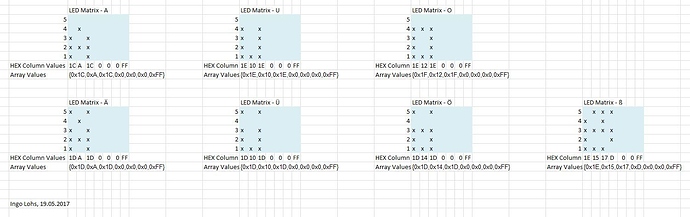

In this moment I feel good to read the strings, but In Germany we have umlauts like ä, ü, ö and ß.
How can I do the necessary conversion in the charactermap.h for these characters?
As example the definitions in my charactermap.h for my beam is as described:
uint8_t charactermap[66][7] = {
{0x00,0x00,0xFF,0xFF,0xFF,0xFF}, // SPACE
{0x17,0x0,0xFF,0xFF,0xFF,0xFF,0xFF}, // !
{0x3,0x0,0x3,0x0,0xFF,0x0,0xFF}, // "
{0xA,0x1F,0xA,0x1F,0xA,0x0,0xFF}, // #
{0x17,0x15,0x1F,0x15,0x1D,0x0,0xFF}, // $
{0x12,0x8,0x4,0x12,0x0,0xFF,0xFF}, // %
{0xA,0x15,0xE,0x10,0x0,0xFF,0xFF}, // &
and so on
Can I define my necessary ö, ä, ü and ß here with a characterline on top or should I convert it with a bit code?

To send to a dot display you’d need to create the correct bit pattern at the correct place in the font definitions.
For different higher level targets you may need to translate the 8bit ASCII code to the required target.
For the String output I use a Hoverlabs Beam with own Libary. For this I had already opened a thread. Within the Libary there is a charactermap.h file, which takes the translation into pixels that can be displayed for the LED. Unfortunately the German umlauts are missing here and I am looking for a way to supplement this as in the example above in the simplest case in the list.
I do not know how the ASCII code looks for ä, ö, ü and ß for a test.
The best would be to extend the pixels table in that header and put the Umlaute in their usual places (Ä=0xC4=196, Ö=0xD6=214, Ü=0xDC=220, ß=0xDF=223, ä=0xE4=228, ö=0xF6=246, ü=0xFC=252).
If you are using Windows you can open charmap.exe to get the ASCII codes, or you can google too :wink:

I guess since there is a constant offset, to keep the array smaller and just skip the non-printables 0x00..0x1F, but I'd assume the rest are consecutive characters.
What character is the first in the array?
Look up it's normal ASCII position and subtract that from 0x5A and then count the position of the Z-line.
Have a look at the binary representation of the seven bytes
{0x11,0x19,0x15,0x13,0x0,0xFF,0xFF}, // Z
would translate to
0x 11 = 0b 00010001 |   .   .|
0x 19 = 0b 00011001 |   ..  .|
0x 15 = 0b 00010101 |   . . .|
0x 13 = 0b 00010011 |   .  ..|
0x 00 = 0b 00000000 |        |
0x FF = 0b 11111111 |........|
Flip that dot pattern 90° and look at a Z

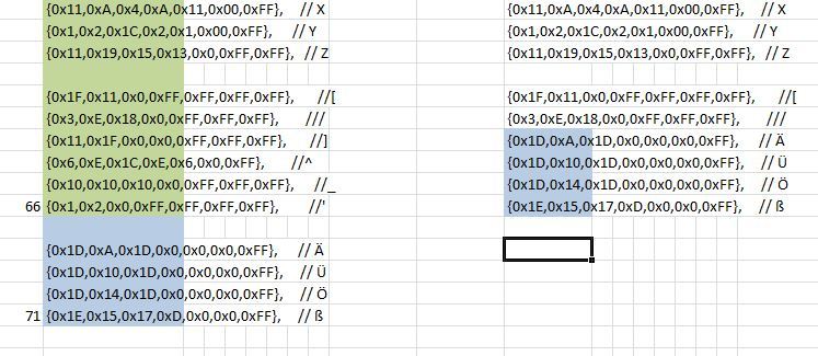

I add the function completely to:
{0x3,0x0,0xFF,0xFF,0xFF,0xFF,0xFF},       // '
{0xE,0x11,0x0,0xFF,0xFF,0xFF,0xFF},      // (
{0x11,0xE,0x0,0xFF,0xFF,0xFF,0xFF},      // )
{0x5,0x2,0x5,0x0,0xFF,0xFF,0xFF},       // *
{0x8,0x1C,0x8,0x0,0xFF,0xFF,0xFF},      // +
{0x10,0x8,0x0,0xFF,0xFF,0xFF,0xFF},      // ,
{0x4,0x4,0x0,0xFF,0xFF,0xFF,0xFF},       // -
{0x10,0x0,0xFF,0xFF,0xFF,0xFF,0xFF},      // .
{0x18,0xE,0x3,0x0,0xFF,0xFF,0xFF},      // /
{0x1F,0x11,0x1F,0x0,0xFF,0xFF,0xFF},    // 0
{0x2,0x1F,0x0,0xFF,0xFF,0xFF,0xFF},      // 1
{0x1D,0x15,0x17,0x0,0xFF,0xFF,0xFF},    // 2
{0x15,0x15,0x1F,0x0,0xFF,0xFF,0xFF},    // 3
{0x7,0x4,0x1F,0x0,0xFF,0xFF,0xFF},      // 4
{0x17,0x15,0x1D,0x0,0xFF,0xFF,0xFF},    // 5
{0x1F,0x15,0x1D,0x0,0xFF,0xFF,0xFF},    // 6
{0x1,0x1,0x1F,0x0,0xFF,0xFF,0xFF},      // 7
{0x1F,0x15,0x1F,0x0,0xFF,0xFF,0xFF},    // 8
{0x17,0x15,0x1F,0x0,0xFF,0xFF,0xFF},    // 9
{0xA,0x0,0xFF,0xFF,0xFF,0xFF,0xFF},       // :
{0xA,0x0,0xFF,0xFF,0xFF,0xFF,0xFF},       // ;
{0x4,0xA,0x11,0x0,0xFF,0xFF,0xFF},      // <
{0xA,0xA,0xA,0x0,0xFF,0xFF,0xFF},       // =
{0x11,0xA,0x4,0x0,0xFF,0xFF,0xFF},      // >
{0x1,0x15,0x7,0x0,0xFF,0xFF,0xFF},      // ?
{0x1F,0x11,0x1D,0x15,0x1F,0x0,0xFF},  // @
{0x1F,0x05,0x05,0x1F,0x00,0xFF,0xFF},  // A
{0x1F,0x15,0x15,0x0A,0x00,0xFF,0xFF},  // B
{0x0E,0x11,0x11,0x0A,0x00,0xFF,0xFF},  // C
{0x1F,0x11,0x11,0x0E,0x00,0xFF,0xFF},  // D
{0x1F,0x15,0x15,0x15,0x00,0xFF,0xFF},  // E
{0x1F,0x5,0x5,0x0,0xFF,0xFF,0xFF},     // F
{0x1F,0x11,0x15,0x1D,0x0,0xFF,0xFF},   // G
{0x1F,0x4,0x4,0x1F,0x0,0xFF,0xFF},     // H
{0x11,0x1F,0x11,0x0,0xFF,0xFF,0xFF},   // I
{0x18,0x10,0x1F,0x0,0xFF,0xFF,0xFF},   // J
{0x1F,0x4,0x1B,0x0,0xFF,0xFF,0xFF},    // K
{0x1F,0x10,0x10,0x0,0xFF,0xFF,0xFF},   // L
{0x1F,0x2,0x4,0x2,0x1F,0x00,0xFF},     // M
{0x1F,0x2,0x4,0x8,0x1F,0x00,0xFF},     // N
{0xE,0x11,0x11,0x11,0xE,0x00,0xFF},    // O
{0x1F,0x5,0x7,0x0,0xFF,0xFF,0xFF},     // P
{0x1F,0x11,0x15,0x19,0x1F,0x00,0xFF},  // Q
{0x1F,0x5,0xD,0x17,0x0,0xFF,0xFF},     // R
{0x17,0x15,0x15,0x1D,0x0,0xFF,0xFF},   // S
{0x1,0x1F,0x1,0x0,0xFF,0xFF,0xFF},     // T
{0x1F,0x10,0x10,0x1F,0x0,0xFF,0xFF},   // U
{0x7,0x8,0x10,0x8,0x7,0x00,0xFF},      // V
{0xF,0x10,0xC,0x10,0xF,0x00,0xFF},     // W
{0x11,0xA,0x4,0xA,0x11,0x00,0xFF},     // X
{0x1,0x2,0x1C,0x2,0x1,0x00,0xFF},      // Y
{0x1F,0x11,0x0,0xFF,0xFF,0xFF,0xFF},       //[
{0x3,0xE,0x18,0x0,0xFF,0xFF,0xFF},        ///
{0x11,0x1F,0x0,0x0,0xFF,0xFF,0xFF},       //]
{0x6,0xE,0x1C,0xE,0x6,0x0,0xFF},        //^
{0x10,0x10,0x10,0x0,0xFF,0xFF,0xFF},      //_
{0x1,0x2,0x0,0xFF,0xFF,0xFF,0xFF},         //'
I would like to insert the lowercase letters and the umlauts.

If you want to add the Umlaute, you need to get the hang of that in order to create the pixel matrix for your custom symbols.
Draw up a 7x8 matrix, draw your set pixels in it till you like your symbol and then put a 1 for each set pixel and a 0 for each clear pixel.
Or just use binary (0b00000000) instead of hex (0x00) - just remember the 90° flip.
If the first letter in your charmap[][] is the blank/space character you have an offset of 32, since this is the ASCII code for it, but the index in the array is 0.
Consequently the exclamation mark (index 1 will be ASCII 33 or 0x20). But the capital Z (0xFA = 250 -> 250 - 32 = 218) would be outside of that 66 element array, so there must be some extra logic that bridges some gaps in the character definition.
You need to locate that logic and add some special treatment for the Umlaute there.
You also need to extend the charmap to add the extra characters.
Thank you for the path you showed - I will go to Him!
Today I created the necessary hex codes to complement charactermap.h and add my Excel template for documentation. So far I am quite happy and have taken a step further.
When adding the charactermap.h to my special characters I made from the original array “uint8_t charactermap [66] [7] = {” [71] [7]: but without success.
In my second try, I decided to keep the original array and to exchange a few existing special characters with my desired one.
Both paths did not lead to success!
Your help “Search for an extension logic” following, I have the frames.h viewed, but does not open up to me their contents:

Can you post a link to the library you are using?
Libary: https://github.com/hoverlabs/beam_particle
This part in beam.cpp needs extending to cater for the extra characters
      asciiVal = toupper(text[i]);
      if (asciiVal == 32){
        fontptr = &charactermap[0][0];   //set fontptr to matching font
      } else {
        fontptr = &charactermap[(asciiVal-32)][0];   //set fontptr to matching font
although this logic isn’t too safe to start with :wink:
I’d change this to something like
      if ( 32 <= asciiVal && asciiVal <= 64 ) {
      else {
        switch(asciiVal) {
          case 'Ä':
            fontptr = &charactermap[65][0];
            break;
          case 'Ö':
            fontptr = &charactermap[66][0];
            break;
          case 'Ü':
            fontptr = &charactermap[67][0];
            break;
          case 'ß':
            fontptr = &charactermap[(68)][0];
            break;
          default:
            break;
BTW, ' isn’t actually index 66 but only 64, hence my check goes for 64 and ‘Ä’ will be found at 65.
