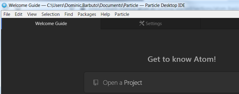

I am a newbie to Particle programming and so far have used only libraries that are listed in the Particle environment. I wanted to use a library I saw online. I installed the Particle editor (Atom) editor. I can’t seem to be able to find any of the projects I have done online, or if I try to access the libraries, I get an error message. image
Particle Dev (Atom) was deprecated a few years ago. Could you try using Particle Workbench (VSCode)?
Hi- and thanks for the fast response. I think I am using the version you recommended.
By the way, does depreciated mean obsolete?
