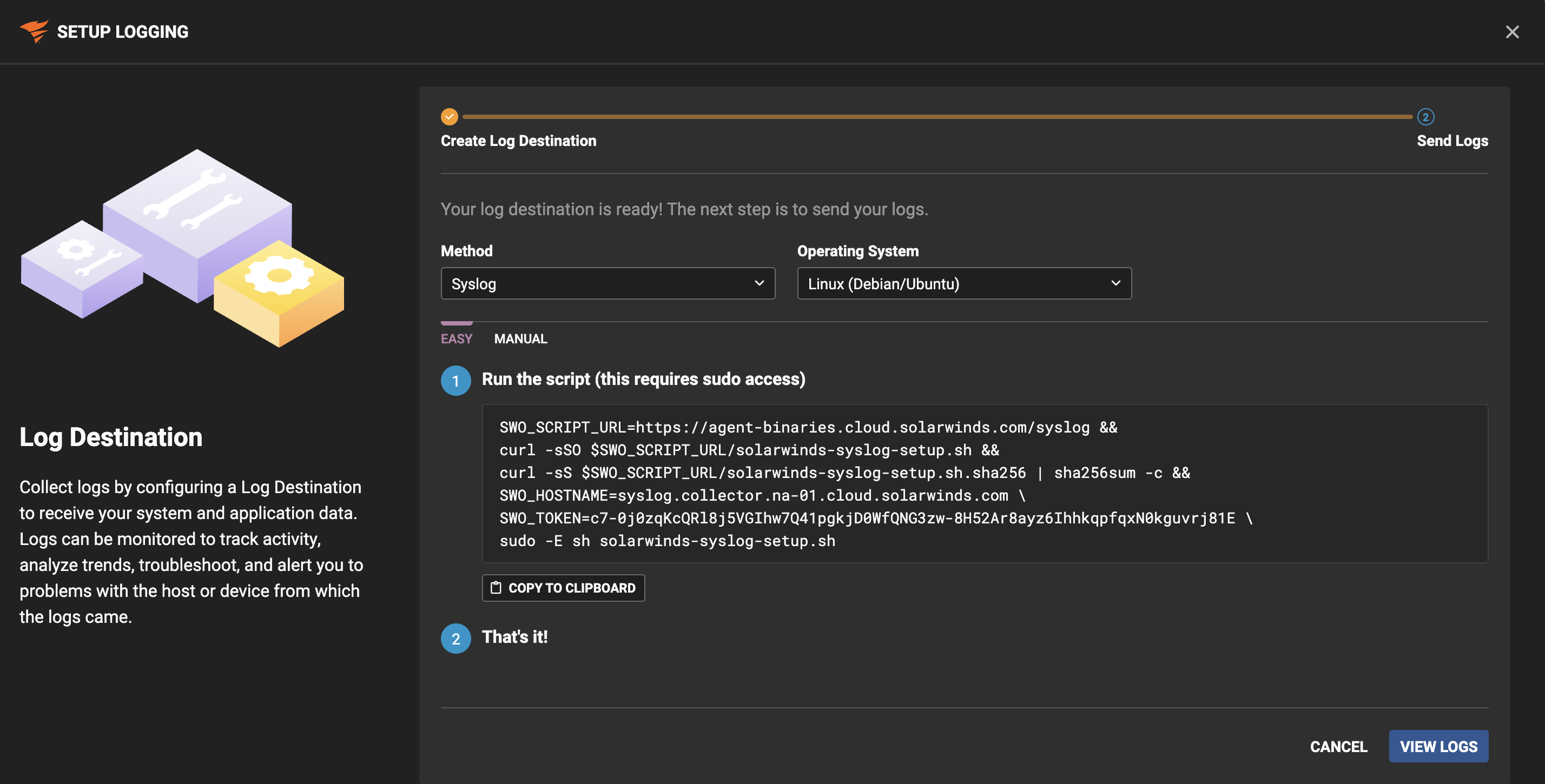

You may then click on the syslog tab:
Here is what the manual tab offers:
But there are no other options to choose from. I tried using http://syslog.collector.na-01.cloud.solarwinds.com/ as the host name and 6514 as the port, but I see no option to specify the incoming IP address. Nor do I know what that would be for for a cell connection. Furthermore, it looks like the new observability account requires an auth token.
I really don’t think the UDP option exists for new users. I would love to use papertrail as it seems like the simplest and cheapest option after doing some research, but I’m not seeing a way forward. What am I missing?
