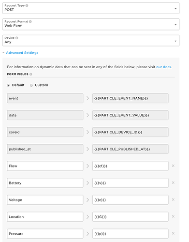

It’s not the script that is affecting your data its the way you are publishing it or matching it to your sheet. Now with that said I am only guessing as others here have much more knowledge than I do. Here is how my data gets published and a screen shot of the matching webhook to google sheets.
See these examples.

Now the screenshot of the matching google sheets webhook.
Super - works exactly how I was hoping it would. Thanks for sharing your script and settings - main change was using the default form fields and extra rows for own data and also the format of the published message.

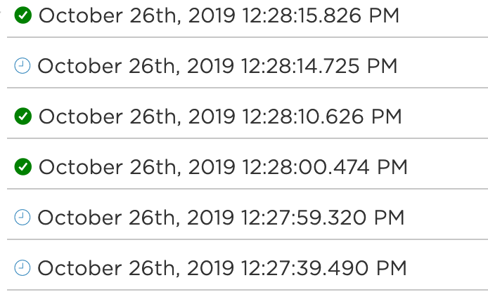

HTTP 409 would indiacte a request conflicting with the current state of the server.
What is your webhook doing?
Is the respective resource (e.g. file) also used by others or otherwise?
Hi @ScruffR the webhook is sending json data to the google sheet and is being received by the script noted in this thread. I commented out the wait lock for the time being and I’m no longer getting the 409 errors, but now I’m getting a clock symbol next to the event logs under that integration. Do you know what that might mean? Here is what it looks like.
