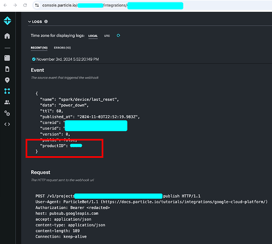

I was excited to see the productID field in the logs for the Google integration:
However, I see it's not being received by Google Pub/Sub. Is there a way to ensure it gets propagated?
Thanks!
Those are the source event fields.
Unfortunately the message attributes in the Google PubSub message do not appear to be configurable. It looks like device_id, event, published_at, and fw_version are the only attributes that are added and are hardcoded.
