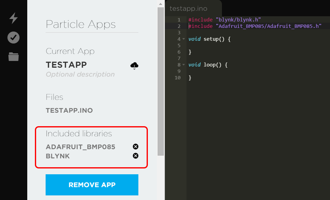

Does your Particle Build really display your project like this?
ScruffR, I appreciate the help. Sorry we got off on a bad step.
My build looks like this. I was just trying to get started, but i couldn’t even get the libraries to verify.
Thanks for your help.
That’s very odd as it works for me, so my next guess would be to check the device and firmware version you are targetting with Build.
You could also try adding a blank line at the top (don’t ask :confused:)

The blank line seemed to help. (strange)
I also added the application.h library in place of the older wire.h. That seemed to help too. I had seen that in one of you previous post on ā€œportingā€.
Thanks
The blank line also has to do with the preprocessor playing up (sometimes with sometimes without the blank line)
