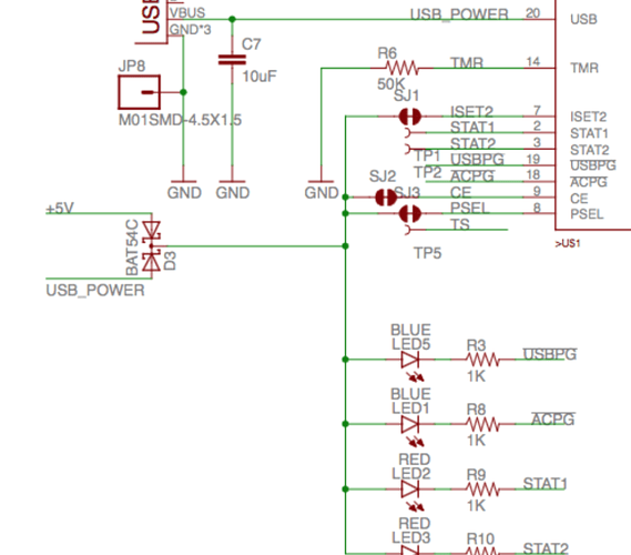

What does the dual zener diode is for at the +5 Input?
Hi @frlobo
Those are not zener diodes but schottky diodes instead. That part acts like an OR gate for power, letting either the +5V supply or the USB_POWER supply power to the common connection.
Thank you BKO. Appreciated!
