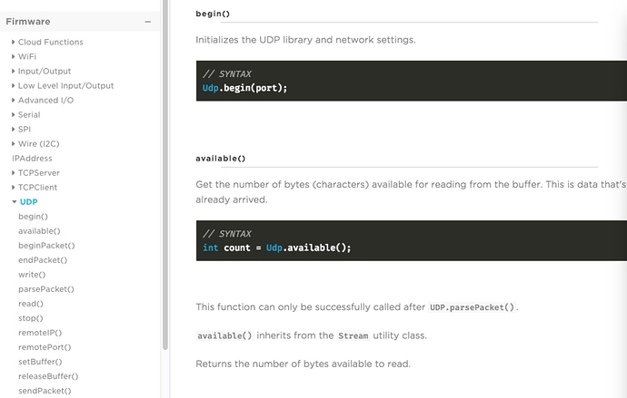

I checked out the document in particle.io, find out from firmware side we can setup a UDP server:
Is this a configuration for start a UDP server in Electron, then we can use our UDP owncloud connect Electron?

The internal Particle cloud connection does not use the Arduino interface that you pointed to the doc for above–that is for you as programmer to create your own UDP connections to other hosts. It uses a similar but lower level interface.
