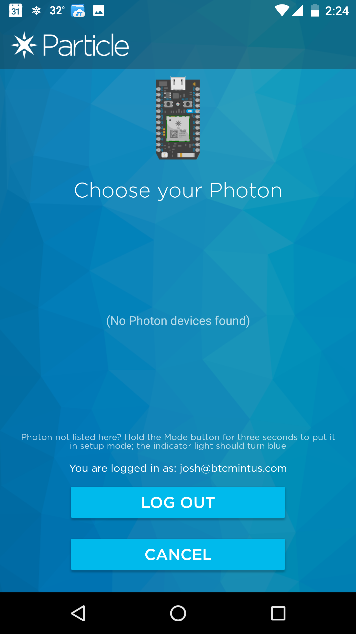

I am trying to deploy 5 units remotely and it seems that it wonât allow me to setup the WiFi with my cell phone a second time, even after wiping the devices from my particle account, re-pairing them with the account, and on first try my device sees the WiFi connection in its list of available connections, but not inside the Android app, and device continues to blink blue-off-blue-off.
