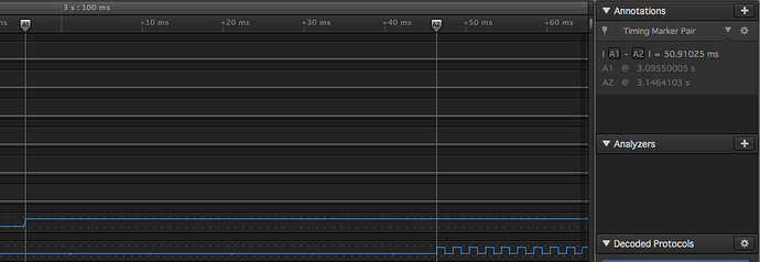

For my application it is important to get a PWM active as soon as possible after power on.
Some measurement we just did puts the time between power on and PWM active at around 2.2 seconds. That’s a bit long. Is there a way of speeding this up?
