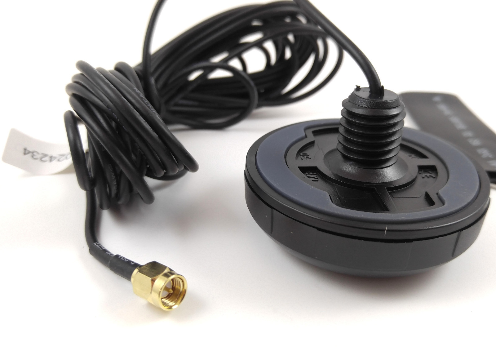

You could use an antenna like this:
there are gps and gprs versions at least.
