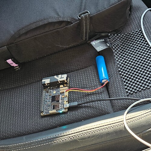

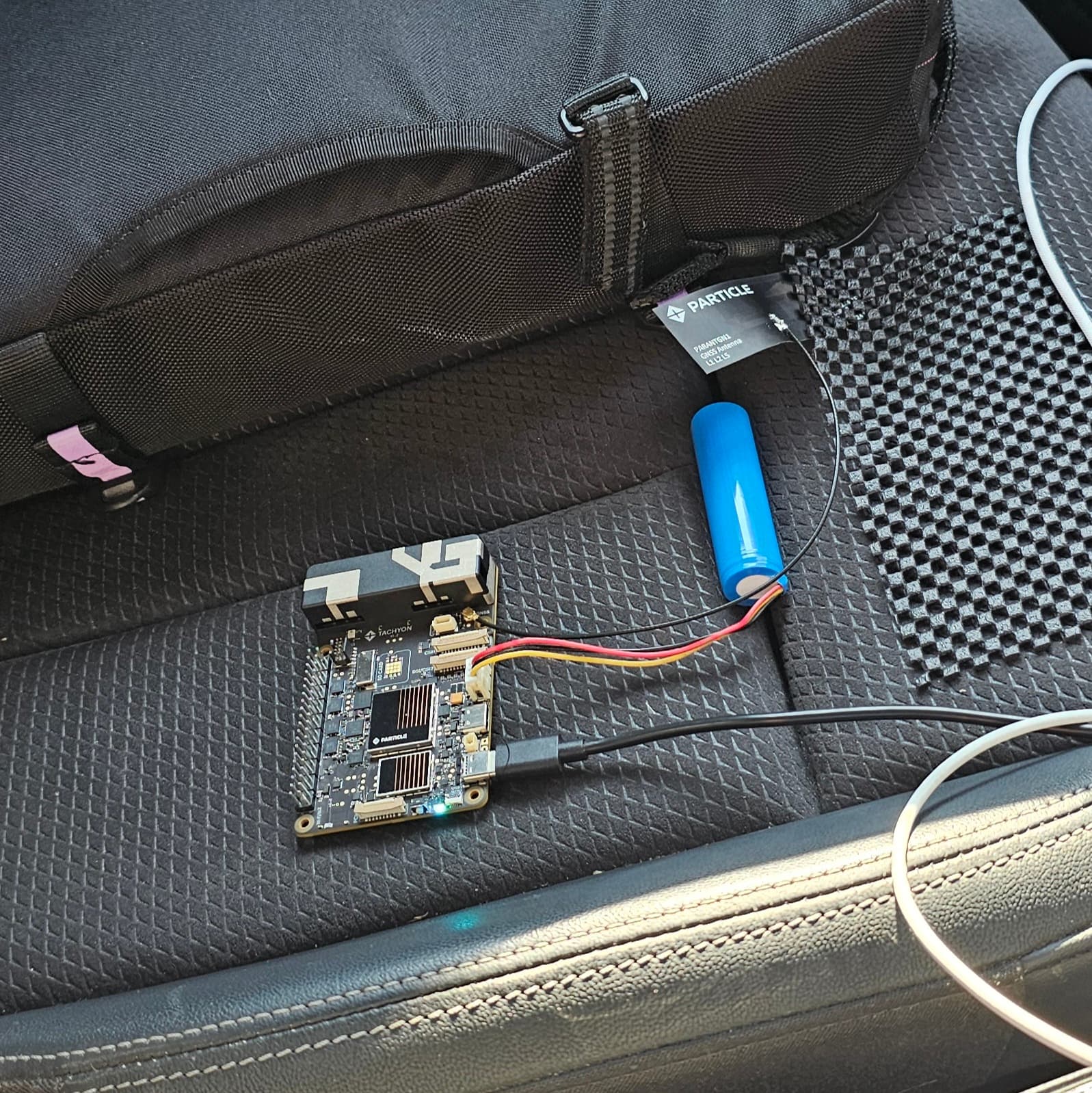

Tachyon chilling on the passenger seat earlier today...
