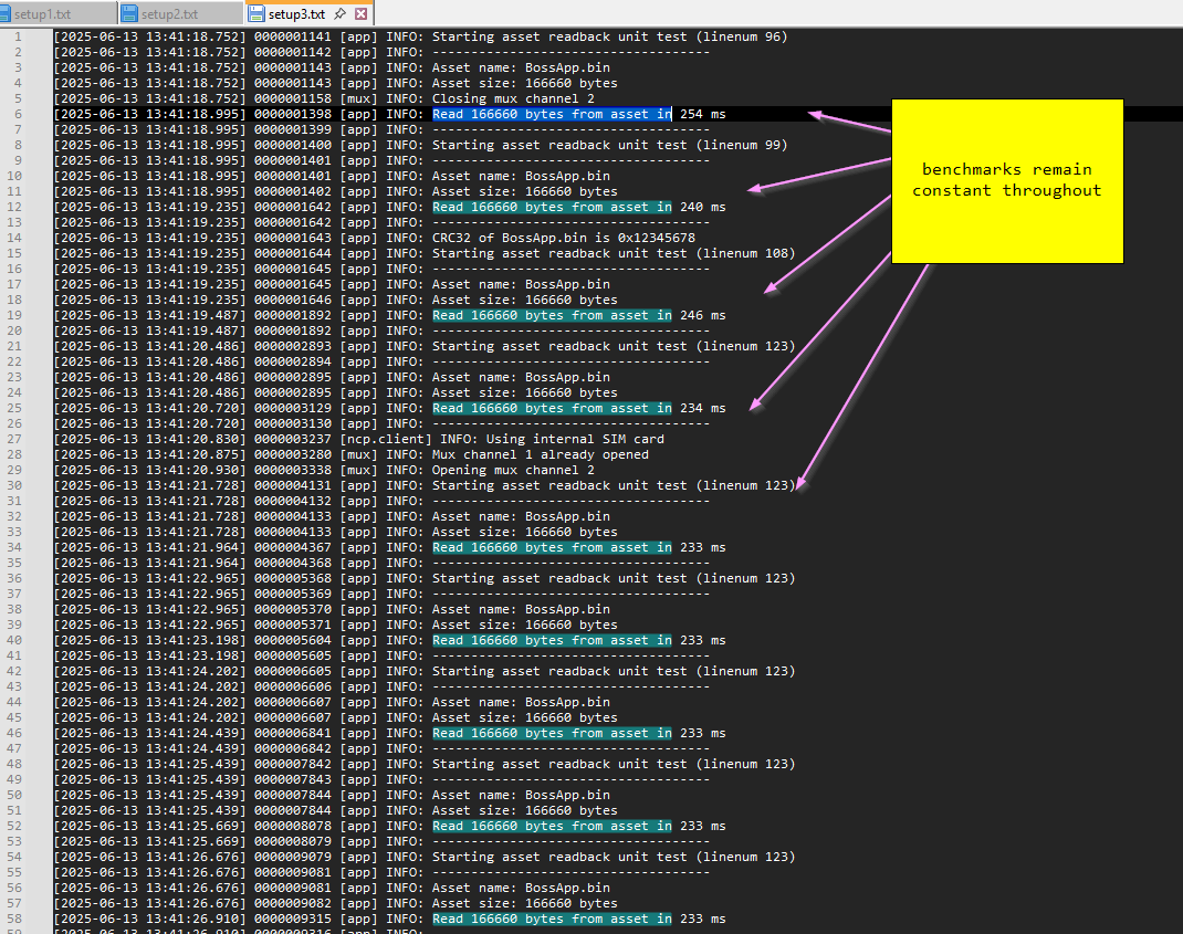

//This function's benchmarks are fast at first (sub 300 ms) but jump to more than 16000 ms towards end of setup function
void setup1() {
    // Put initialization like pinMode and begin functions here
    Serial.begin(230400);
    waitFor(Serial.isConnected, 1000);
    asset_readback_benchmark(__LINE__); //! 245 ms
    //Proxy for linknet_init();
    Serial1.begin(230400);
    asset_readback_benchmark(__LINE__); //! 239 ms
    //Calculate the CRC32 of the Asset
    auto assets = System.assetsAvailable();
    for (auto& asset: assets) {
        if (asset.name() == "BossApp.bin") {
            uint32_t crcResult;
            crcResult = compute_CRC32(
                asset, (512*1024) - asset.size(), &crc32_mpeg2
            Log.info("CRC32 of %s is 0x%08X", asset.name().c_str(), crcResult);
    asset_readback_benchmark(__LINE__); //! 16595 ms

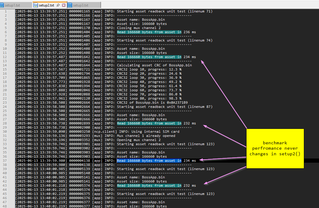

//This function's benchmarks are fast throughout the function after adding enclosing scope brackets around the auto assets block
void setup2() {
    asset_readback_benchmark(__LINE__); //! 233 ms
    asset_readback_benchmark(__LINE__); //! 234 ms
    { //! <--- The only difference between setup1() and setup2() is that this block is wrapped in scope brackets
                uint32_t crcResult = compute_CRC32(
                Log.info("CRC32 of %s is 0x%08lX", asset.name().c_str(), crcResult);
    } //! <--- The only difference between setup1() and setup2() is that this block is wrapped in scope brackets
    asset_readback_benchmark(__LINE__); //! 270 ms (still fast)

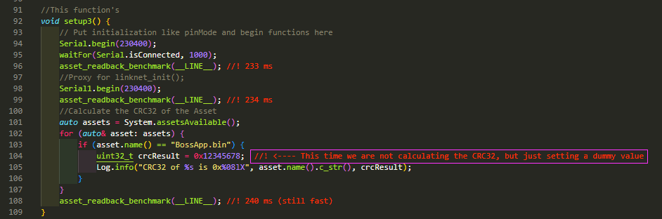

void setup3() {
            uint32_t crcResult = 0x12345678;  //! <---- This time we are not calculating the CRC32, but just setting a dummy value
    asset_readback_benchmark(__LINE__); //! 240 ms (still fast)
void setup(){
    // setup1(); //Benchmark slow at end of setup, but fast at beginning, and back to fast again during loop
    // setup2(); //Remains fast throughout setup and loop, because of addition of enclosing scope brackets?
    setup3(); //Remains fast throughout setup and loop, because no CRC32 calculation was performed?

Debug outputs
I compiled and ran this project 3 times, using the 3 different setup() functions (setup1() , setup2() , setup3() )
There are three debug output logs which illustrate the various results:
setup1() log
setup2() log
In setup2(), the only difference is that enclosing scope brackets were added around the code block that calculates the crc32 of the asset
setup3() log
