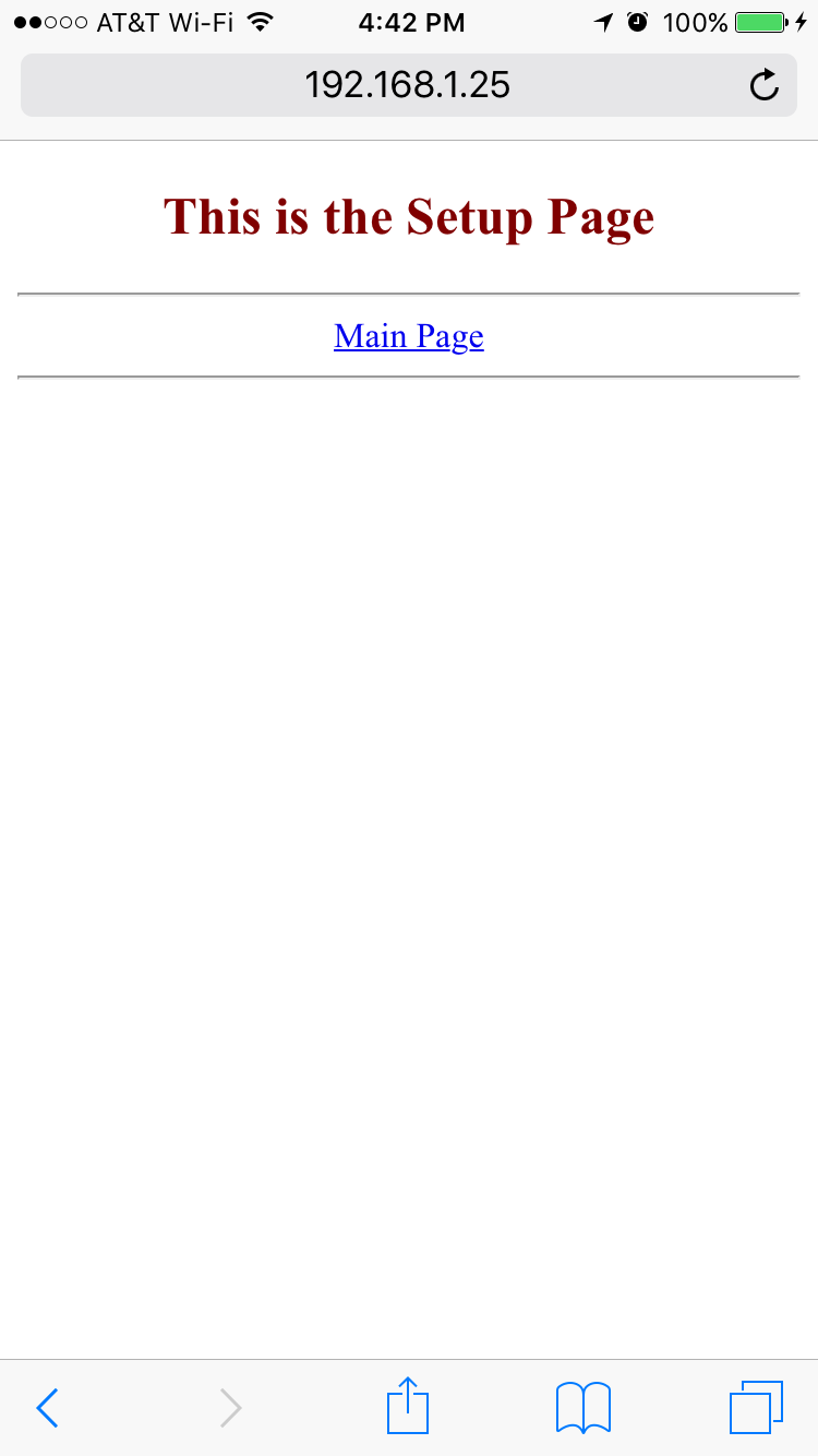

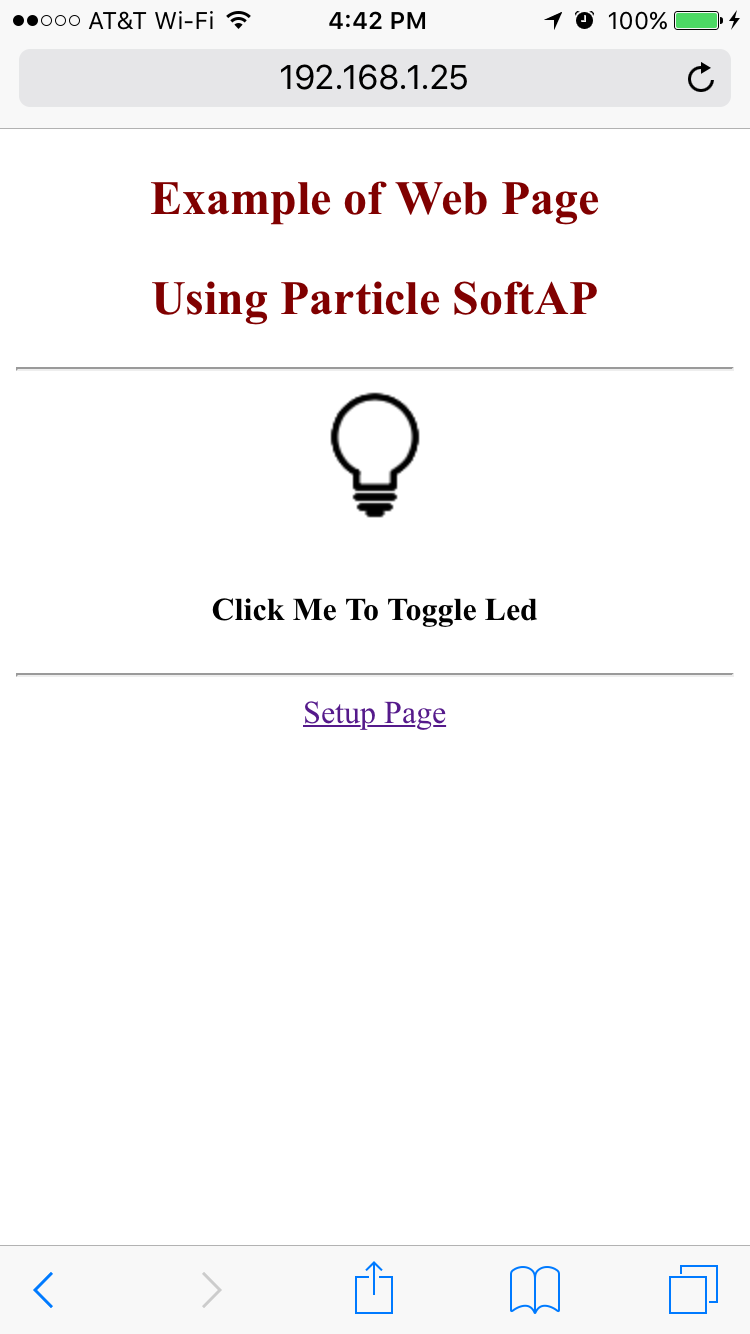

So, a snowy day here gave me a little time between sledding and snowball fights…
An example of what I was looking for, using your base code follows. It works like this:
  1. uses the basic SoftAP code with WiFi discovery - I had to use that to get all of the Wi-Fi html out of the Photon.
  2. It has two web pages, once connected… a main and a setup with links to each other.
It works, but my coding is a bit of a kludge… any suggestions would be appreciated.

            const FileInfo* ptrToPage;
            if (strcmp(url, "/") == 0) {
              url = "/index.html";
              Serial.println("Load Main Page");
              ptrToPage = mainPage;
            else if (strstr(url, "setup") != 0)
              Serial.println("Load Setup Page");
              ptrToPage = setupPage;
            else
            Serial.printlnf("%d: request: %s", clientId, url);

            if (index >= 0) {
              responseCode = 200;
              responseStr = "OK";
              fileToSend = &ptrToPage[index];
              Serial.printlnf("%d: sending %s index=%d", clientId, fileToSend->name, index);
