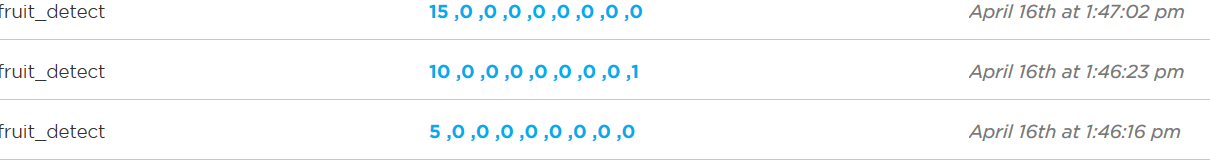

I added the digitalRead in the String and it is only triggering once, I have triggered it everytime I trigger the prox so the prox value and photoeye should be equal.
The point is, the way you are doing this the trigger has to happen at the exact time your are calling PublishLaneCount(). You are publishing whether there currently is a trigger active when you publish or not.
I guess this is not what you want.
Do you not rather want to count the triggers into your array LaneCount[] and then after some time collecting data publish the content of that very array - instead of the current pin states?

So this worked to give me the correct count
    //photoelectric counter
    const int NumberOfLanes = 8;
    int LaneSensor[] = { D0, D1, D2, D3, D4, D5, D6, D7 };
    int ProxSensor = A0;
    int Cycle = 0;
    int val = 0; //variable for reading pin status
    int LaneCount[NumberOfLanes]; //counter variable for dectection
    int CycleSensorDebounce = 0;
    void setup()
      for (int i = 0; i < NumberOfLanes; i++)
        pinMode(LaneSensor[i], INPUT_PULLDOWN);
      pinMode(ProxSensor, INPUT_PULLDOWN);,
      Serial.begin(9600);
      initializeLaneCount();
    void initializeLaneCount()
        LaneCount[i] = 0;
      Cycle = 0;
    String PublishLaneCount()
      String StringReturn = String(Cycle);
        StringReturn += " ," + String(LaneCount[i]);
      return StringReturn;
    void loop()
      val = digitalRead(ProxSensor);
      if (val == 0)
      else
        if (5 >= CycleSensorDebounce);
          CycleSensorDebounce++;
          if (5 == CycleSensorDebounce)
            Cycle++;
              if (digitalRead(LaneSensor[i]))
                LaneCount[i] = LaneCount[i] + 1;
            if (Cycle%5 == 0)
              Particle.publish("fruit_detect", PublishLaneCount()); //publish event and counter
