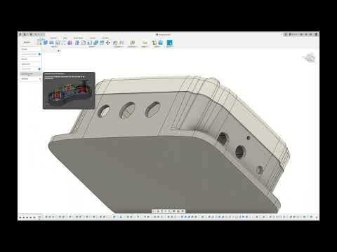

I thought I’d take a few minutes and share the technique/process I use to make holes in small enclosures that then contain the Particle hardware. Hopefully others will gain some inspiration from it. I know when I started down this path it was a bit daunting but now that I’m here I’m glad I spent the additional time to learn and have the process down to make any hole in any enclosure quickly.
Rather than typing in words, I thought I’d use a short video to explain the process:
Here’s a quick picture if you don’t want to take the time to view the video:
