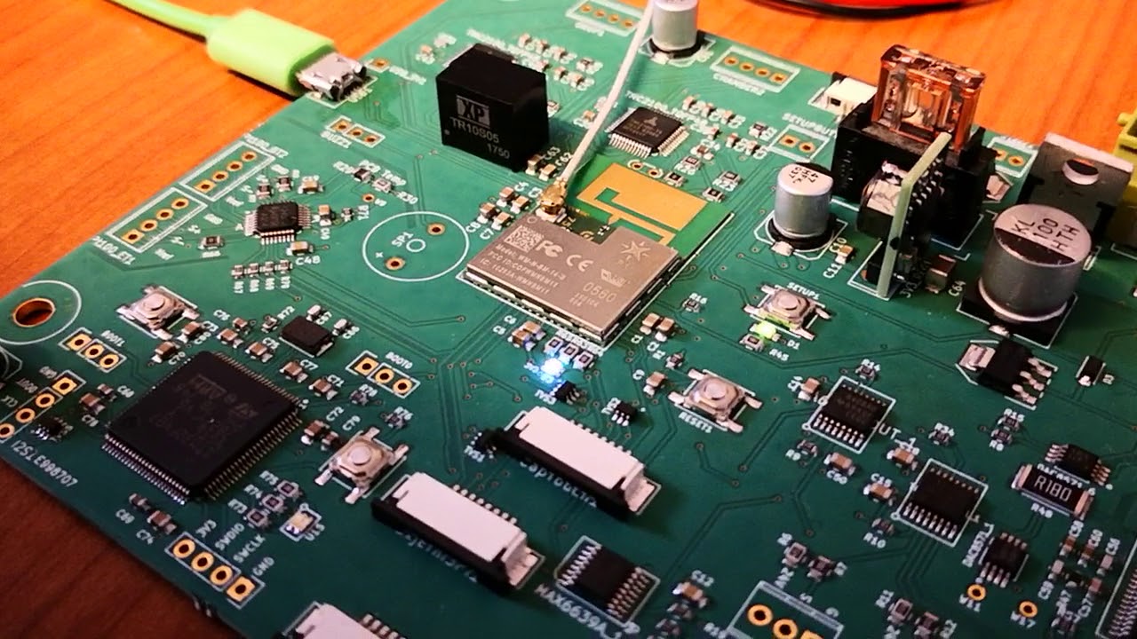

I have discovered what must be a bug in our firmware, but I would like it confirmed by others. For a while now, we’ve had problems related to setting up our P1 based boards. We did not have this problem before and I have confirmed it’s not a hardware issue.
The core problem is that if I’m running Tinker, I can setup wifi using either CLI, app on iOS/Android, via commandline by passing credentials or setup.particle.io. If however I’m running our firmware, the setup will timeout or fail on all of the above methods. So this MUST be related to our firmware in some way, but how? What in our firmware could possibly prevent wifi setup from working?

Here's something crucial that I discovered: clearing credentials does not work and the module shows this clearly:
Instead of clearing the credentials and returning to setup mode, the device blinks fast red. I presume this could be key information that someone might know what means?
