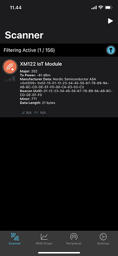

Hi Phil and others,
I might be running in the same issue as you - I have a Acconeer XM-122 (using the NordicSemi nRF52840 module) and I can discover it using the nRF Connect app. As far as I can see on the advertised data, it should be in the beacon mode, but I am unsure whether this means nRF Beacon type or iBeacon type, since I cannot scan it using the scanAndPublish example in the library - any ideas to what it could be?
Page 11 of the following document is what I am doing: https://developer.acconeer.com/download/xm122-software-development-guide-pdf/
Screenshot of nRF Connect App.
from the doc they only seem to mention the nrf beacon type, not ibeacon. I think the nrf connect app should be able to show the beacon type based on the screenshot p.13
It did! I did some ‘raw’ searching of nearby beacons using the library after I made a new beacon type based on the iBeacon interface - it works. Thanks!
