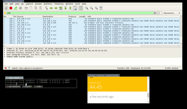

With the above information in mind I made two tests for sending data through TCP and UDP, the common between them is that I manage the network and in some time I block the DNS service so the device would not send data because it can not get properly the IP, below are the results:
TCP:
through TCP once the DNS service is down (refer to the down left console) the data doesn’t arrive to the Ubidots end. When I make it available again, the method connect(_server, PORT) solves successfully the ip of the server and begin to send data properly.

UDP:
The same test as above was done, once the DNS goes down the data sending stops as expected, but when it is available again the method to begin to send packets doesn’t solve properly the DNS (but still follow making requests to solve the domain, so I think that it gets the ip but this one is never updated) and doesn’t return an error so the data simply never goes to the end server.
What I believe is that the randomly stops come when the photon for any reason gets a wrong DNS answer or simply didn’t get it and the memory register is not updated every time that the beginPacket() method is called.
